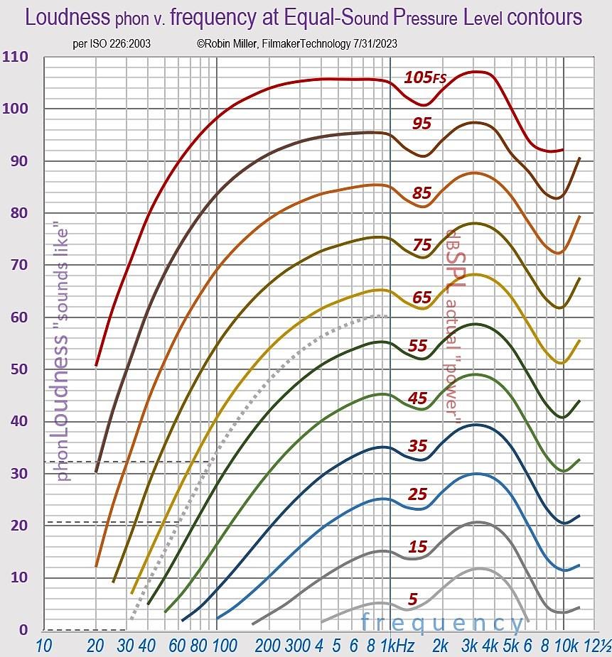

To sound as loud as 55dB in the midrange you need about 105dB at 20Hz and bear in mind that almost all music has a spectrum that is tilted down as frequency increases so you'll need even more sub bass headroom.

I suspect you will perfectly happy with KF92, but it will not give you meaningful (as in you can hear and/or feel) output at 16hz. But I will argue you don't need that either. So there is a conflict between your stated requirements and KF92, but this is probably not because KF92 isn't the right sub for you, but because you are stating a requirement that you can likely live happily without fulfilling.
I’m considering the KC92 solely because of its room friendly size and look myself .
Probably at a >200% price hike to comparable options .
If you can live without the minor improvements the KC version has over the KF you can probably get discounts.
KC has the live saving always on option, many peeps have reported problems with kefs auto on functions on thier older subs.
