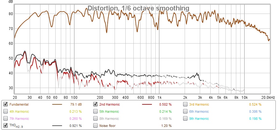

Actually measuring at 1 meter may leave you with a high noise floor. A popular approach is to measure with your mic at 31.5 cm at 96dB and 106dB which are equivalent to the 1 meter SPL of 86dB and 96dB.
The Canadian NRC used two meters, which made their tests up to 100 dB for the speakers that could do it all the more impressive. But, of course, that was in an anechoic chamber. In the chamber there is no room reinforcement, and two meters needs 6 dB more SPL than at one meter.
With REW, I use the listening position, which is greater than two meters by a hair. Here's an example with my Revel F12's.
I think when the REW traces lose their color it's because that harmonic is too affected by noise. But I may have that wrong.
Rick "ambient noise is about 50 dB down here" Denney
