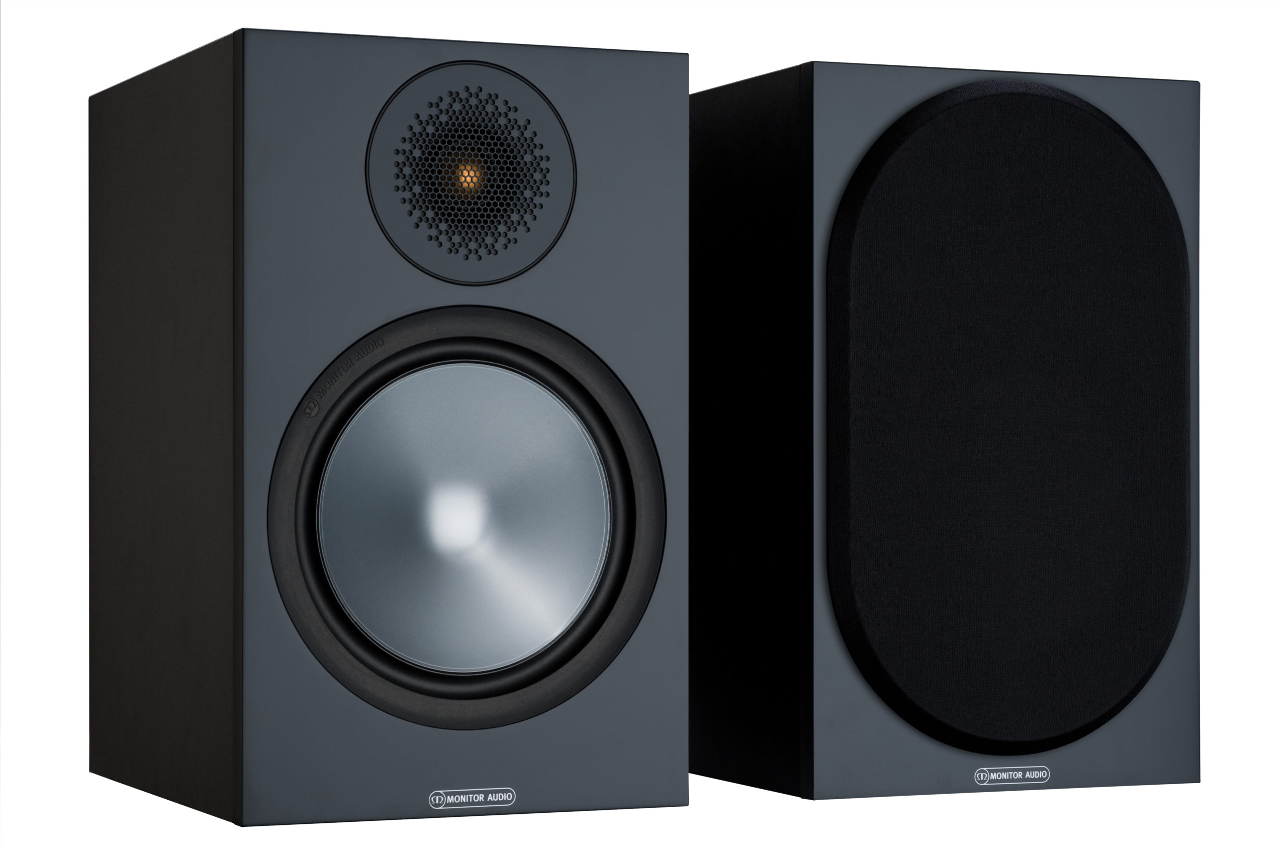

Monitor Audio Bronze 100 might be a good candidate. I scored a used set of the 6g's a while back for $250 shipped on ebay, they just ended up being a bit too large for my room. The newer 7g model should be very similar.
This is an example of a different set of tradeoffs than the Sointuva. The Monitor Silver 100 was reviewed here and looks really nice. It does have higher measured efficiency around 88dB/2.83V/1m, it does so by limiting the bass to F3 to ~80 Hz. To be clear it has much worse distortion % at 50 Hz than the Sointuva, but also has reduced output down low so not an audible problem.:) It still has to obey the laws of physics, cone excursion at 96 dB dictates distortion, and it has some additional resonances/artifacts starting to pop up at 96 dB, perhaps really advanced drivers like the PuriFi units in the Sointuva would help, but this level of distortion is no hill to die on since there are so many other things that are more audible than even 10% bass distortion.

Here they review the Monitor Audio Bronze 100 (germain review)
Erstaunlich hohe Pegel Reserven = Surprisingly high level reserves, they give it max score for sound and distortion but whathifi trash them (couldn't find a better discribtion word in english,danish than trash)
They also wrote (translated from german to english)
And even at the significantly higher level of 101 dB, the distortion of the mid-bass driver (the tweeter does not distort at all at this level!) remains in the moderate range.
