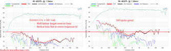

Indeed something is wrong here, This sub should be playing down to 20Hz with low distortion,,
Personally, I choke at the price point: It's downright Wilsonesque. And then there is the issue of the bass roll off. Granted it's anechoic, and there would undoubtedly be room gain, but would the room gain be sufficient to make in room response flat to, say, even 25 hz at 90 db? I don't think so. Kef Ref speakers also have roll offs, but they're nowhere this severe, yet almost all of them except the Blades need subs. So it seems like these would need a sub on top of the existing sub, which would definitely add to the expense and diminish the purity of the concept.
And, just as importantly, they seem to have a great deal of distortion in the bass, despite their claim of having a "motional feedback technology" that "reduces distortion by 30 db." Any number of times I've heard that the distortion levels of my LS 50 Metas in the bass are something of a deal breaker, and I don't know that the Grimm's have lower levels of distortion at those frequencies than that $1000 speaker. So, it looks like there would be a definite ceiling on how loud these speakers can play and how low they could go. And except for the wide dispersion pattern, doesn't something like the Kef LS 60's have a similar performance envelope at one tenth the price if you buy "scratch and dent" (for $4000) at Crutchfield?
Maybe, for some, the whole will be greater than the sum of the parts, but frankly given the near cult-like status of these speakers, they seem like something of a disappointment to me.

Bass extension is vital to me. Every digital music recording that I've checked has significant information down to 20hz across several genres. Even pianos go to 27.5hz. I just find their subs to be unacceptable. I suppose if you could control eight of them it would be fine.
That honestly doesn't make sense to me. One, why wouldn't they send the speaker system pre-configured to provide the best performance? Or at least provide Amir with instructions to configure it properly? Two, using DSP to make it go lower can only exacerbate the distortion issues in the bass. There's obviously some sophisticated DSP at play here and I'm sure the little sub unit is very well integrated, but it's still a small, sealed, heavily-DSP'd sub in the end and that kind of setup quickly runs into limits. Asides from the integration with the mains, you could likely get better performance from something like a Kef KC92, nevermind a "proper" sub.

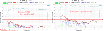

Surprisingly in terms of Distortions, the Neuman KH 150 is still the undisputed King...... for just 1/10 of the price!
