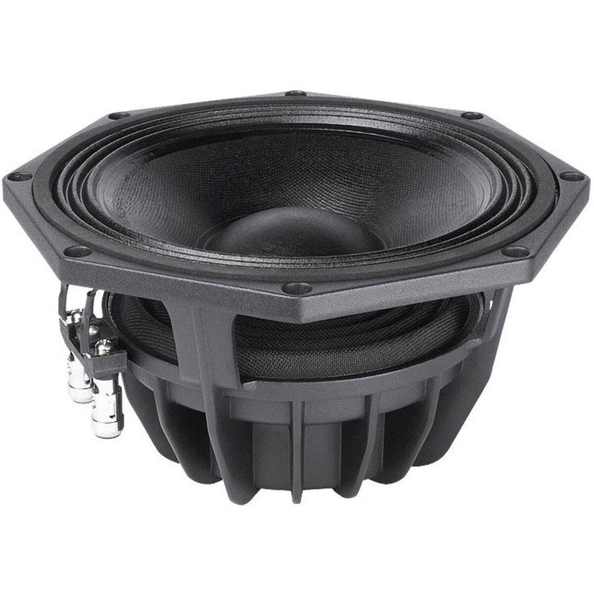

The system seems to have Fairly impressive performance, but now seeing it uses 2- $200 woofers, changed my view of it a decent bit.
