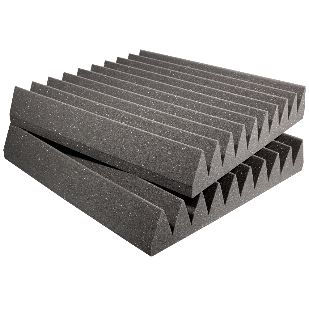

Here is actual data point. He said they bought Auralex wedges. Here is the thickest they sell which is 4 inches deep:
Looks pretty much like what they bought. Here is their certified test data:
Alpha or absorption coefficient needs to be 1.0 for total absorption. As you see above, it doesn't get to that point until 300 Hz! At 160 Hz, it only provides 1/3 absorption with the rest reflected back. Company doesn't even test below 100 Hz!
Alpha or absorption coefficient needs to be 1.0 or total absorption. As you see above, it doesn't get to that point until 300 Hz! At 160 Hz, it only provides 1/3 absorption with the rest reflected back. Company doesn't even test below 100 Hz!
