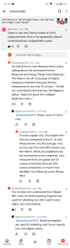

Danny Richie from GR Research answered to my YouTube comment and claimed that nothing of that is true. Why the Heck cant he say that there was something wrong in His Video...
I will Screenshot my comment and uploade here, so usually he deletes complex comments Like this at YouTube...
Edit: there we go, my answer is not there anymore. At least it seems that he deleted his answer too.
