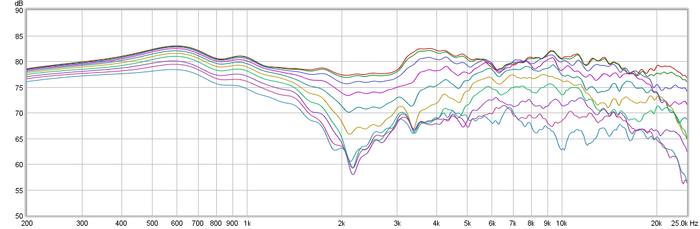

Back to modding - there are people that really do it properly - they take bad audophile speakers with good quality drivers and try to salvage them. E.g. B&W 802D
this is how you should do this stuff, I really like the guy.
Before:
After:
Before:
After:
Great example excellently presented. Thanks.
