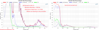

This is the main problem, not what you have measured.
Plus the poor directivity, which you didn’t measure either.
You have an otherwise nice setup. Get some Neumann‘s or Genelec‘s, than you know what great speakers for studio / nearfield can really sound like.

Directivity is not a concern since my application is nearfield...there's little room interaction, and I can point the speakers directly at my ears. Distortion is near or below the noise floor for my typical playback levels:
In my view, the tradeoff is giving up loudness and extension for coherency and time-domain accuracy. One's choice comes down to priorities. I don't feel a need to change this setup anytime soon, but if I ever do, I'll check out Neumann‘s or Genelec‘s. Thanks.
