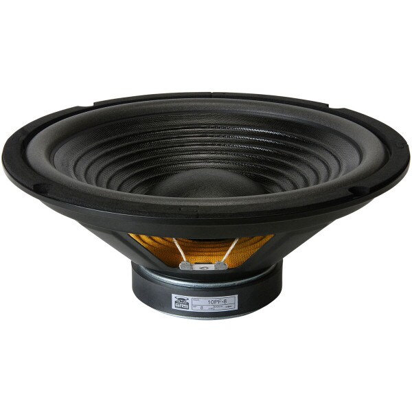

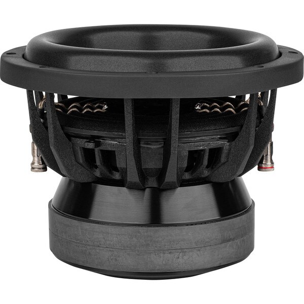

Yes!
2x10" 40 Hz @ 100 dB SPL=3.4526
VS 4x7" the same =3.5231 Xmax.
You can't just compare the size of the drivers. Do you think these drivers have the same capacity? Both are 10"
