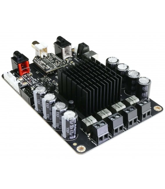

I used 24dB/oct crossover but passive I would not do that, 2nd order should be ok. The biggest problem might be the rather peaky resonance of the tweeter, or not. I am not very experienced with passive crossover design.
I do not know why you can't go active, I ended up using this module to drive a stereo pair.
