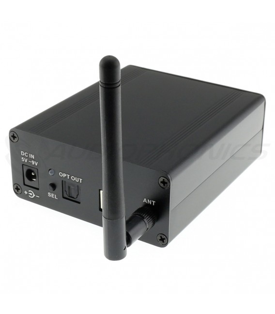

This is the one I got, this is the usb-c/BT version of the above I would guess.
