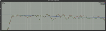

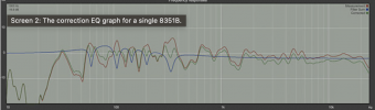

For those who haven't seen it yet (I am sorry if posted already, and I have missed it), It's impressive to see how adding the W371a fixed the massive suckout between 40Hz & 50Hz and effectively provided a ruler flat response to 20Hz.
Oh, so you're comparing two different Genelec systems? I feel like you're burying the lead! Here I assumed you had some home theater subwoofers or something....
should have made it clearer - the multisubs were 2 7360s and 1 7350, all Genelecs
