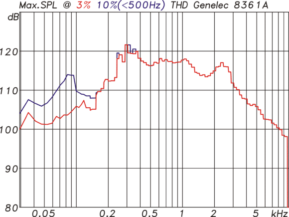

Now if you read Amir’s review he states that even the 8361a is held back by the tweeter. So that is the limit here. The 8351b has the same mid/tweeter. So maybe it will be okay for my purposes?
The reality is that all music is down by 10-20dB by 5khz, if not more. Peak is pretty much always 50-500hz, depending on the bassiness of the music. Tweeter limiting on sweeps doesn't usually matter unless you're using the speaker for research or something. The 8361A/8351B don't limit until 8khz, and even then, they're still playing 10khz, 98dB@1m. No doubt that the 8341A limits much more in that region, as it has a smaller mid/tweeter and less power.
The midrange and upper bass are much more likely to be the bottleneck. Subwoofers do not help much above their crossover, ESPECIALLY Genelec subs which use an 8th order 48db/oct crossover, so they contribute even less than most subs above the crossover.
A while back someone tested an 8351B with no subs and it hit around 112-113dB @ 1m. Of course, it depends the music. If you play something that has really aggressive peaks in the 150-300hz region where subs don't help, then you will limit earlier. Above that the 8361A/8351B play absurdly loud.
That said, for a stereo pair, I'd probably always go 8361A. For multichannel, it's a bit different, as the large number of speakers adds substantial headroom. And it also changes the cost math :P
That said, for a stereo pair, I'd probably always go 8361A. For multichannel, it's a bit different, as the large number of speakers adds substantial headroom. And it also changes the cost math :p
Great point. I think the limitation in my case is midbass. Even vocals cause it to go into protection.
I will assume Genelec knew what they were doing when they made the 8361a and put the power into the mid bass where it will be needed by actual musical sources.
112dB at 1m is good but I am 3m away so I suppose that would be 106dB max for me. It’s just about as much as I want but I also want headroom.
