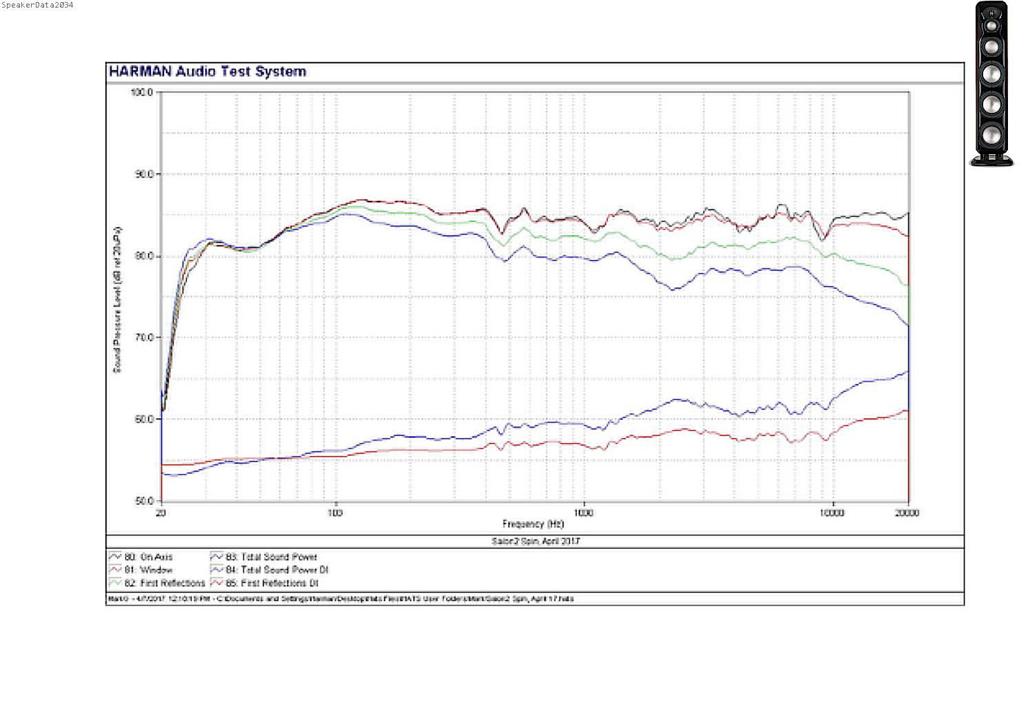

Here is the Spinorama (bass likely wrong) of the Salon2:
As Amir pointed out, the soundstage is wider, the Sound Power DI breaches 5dB around 1500Hz while this Genelec breaches it at a lower 500Hz.
Though we do see a directivity mismatch at 2500Hz :p

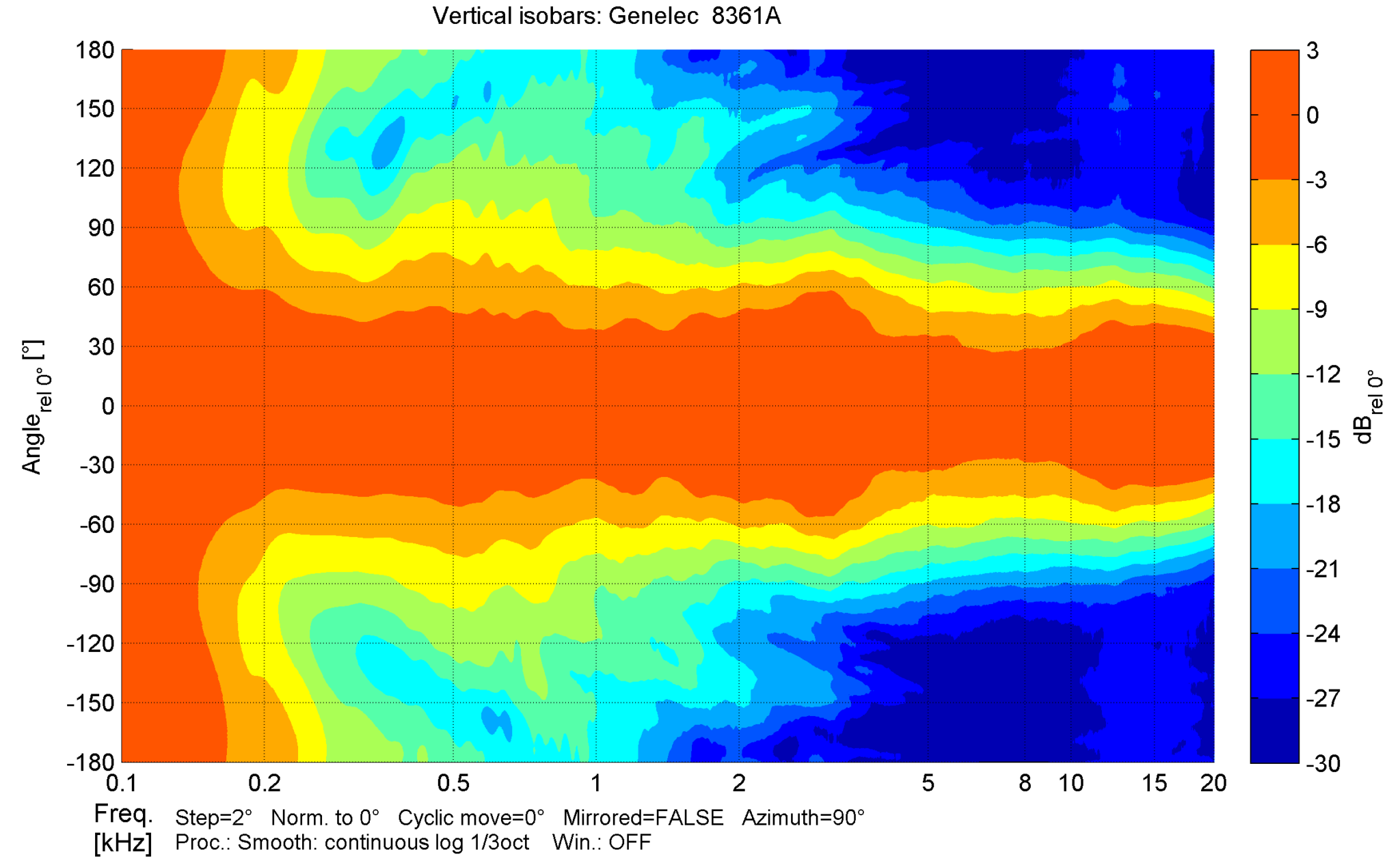

Strangely, S&R's test shows a massively better vertical directivity around 500 Hz than both NFS' and Genelec's own (unless I'm tricked by a difference in SPL color scale).
index.php
index.php
THD seems to track well, with S&R showing a dip in capability between 100 and 150 Hz, where the NFS shows an increase in H4 and H5 at 106 dB.
index.php
index.php

The data is a good fit as I see it.
You've got to be careful to make sure you're visually compensating for the different data ranges on the axes; the S&R isobar runs 100 Hz to 20 kHz versus Amir's 20 Hz to 20 kHz. If you scale the S&R plot so the frequency axis lines overlap, then stretch it in the vertical to the equivalent sizing, the isobars agree -quick and dirty photo editor work for example:
The Genelec data uses a different range on the X-axis again, and only runs -90 to +90 degrees on the Y-axis. All three use log scaling on the X-axis and linear scaling on the Y-axis though, so you can just do the equivalent adjustments. I used the 500 Hz and 8 kHz lines here, it's not pixel perfect but close enough to illustrate:
Just for completeness' sake, S&R versus Genelec:
There are some small anomalies in isobar shape between the plots, but I'd put that down to them using different amounts of smoothing or the measurement environment / method.
