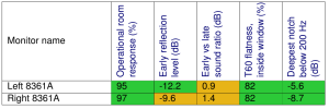

I've got all the first reflection points covered and some 10" corner bass traps, along with some broadband panels scattered throughout to help with reverb. I think GLM grade report thinks I'm doing okay on this front (attached).
After some measurements, it was nothing to do with GLM or its results. I learned that I just have an unusual preference for a lot of bass, and I prefer more of it even if it's uneven. I thought I was over this from my teenage years-- back when I was ridin' dirty with two 12" Rockford Fosgate Power ported subwoofers in the trunk of my car (with everything rattling)-- but it seems like I just need to either go with a more pronounced low shelf or learn to live like a more civilized adult.
In the screenshot below, I offset the SPL to match around 200hz since I was primarily concentrating on bass response. To me, "Stereo Uncalibrated" (8361a, no sub, fully uncorrected) really sounded the best at first, but after adding a few more db to the calibrated (GLM+Dirac) low shelf , I think I prefer "Stereo DIRAC GLM 80hz," which is the 8361a crossed over at 80hz with 2x Klipsch RP-1400sw subs. I don't know if I should add a bit more or if that's just ridiculous. How much clean, even bass is too much?
