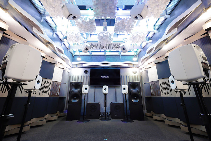

Nice tour of the Genelec Tokyo Center
What was most impressive?
The stereo room was the most impressive. The atmos room, very large, lacking a little thickness in the ceiling atmos
