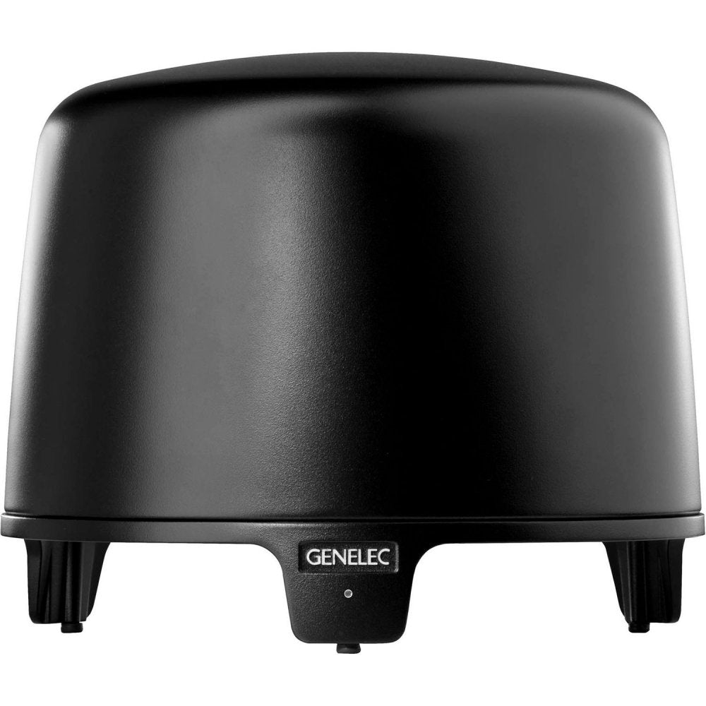

I am awaiting delivery of an F Two sub to go with 8040B monitors. I have a couple of questions about the remote control. Does it work flawlessly for volume control? Can you select input with it? I will be using three inputs - Toslink from television, SPDIF from streamer, and analog from Signalyst DSC3 DAC. It is unclear from Genelec's info if remote control will select input.
The remote volume control works flawlessly. There is intelligent signal sensing (auto on or off); this works very well ime.
You can select input iirc but I haven't used it. The manual seems to say you can switch between digital inputs with the select buttons on the remote, but not between the different analogue inputs.
Thanks, I can rest comfortably until the F Two arrives (two more months of backorder), then the fun begins.
Two months? They do not have direct dealer in North America?
