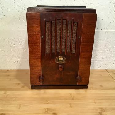

LOL, though I'm thinking more like 1930s art deco tombstone radio, like this Delco model 3201:
I'm not entirely sure why the Genelec subs are that funky looking, actually. I guess it saves on material and the designer liked his art deco? It certainly gives a very 1930s-1950s retrofuturist vibe.
Not so far from that:
I think the design is from the same Harri Koskinen that made the monitors and barely all in Genelecs. Finnish and other Scandinavian decoration is more in the Bauhaus line than art deco IMHO.
