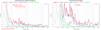

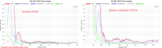

Distortion shows that while both speakers can handle 86dB SPL, the Rokit falls apart at 96dB where the Genelec keeps on trucking:
Genelec 8330a relative distortion vs Frequency Response Meaurements Powered Studio Monitor.png
