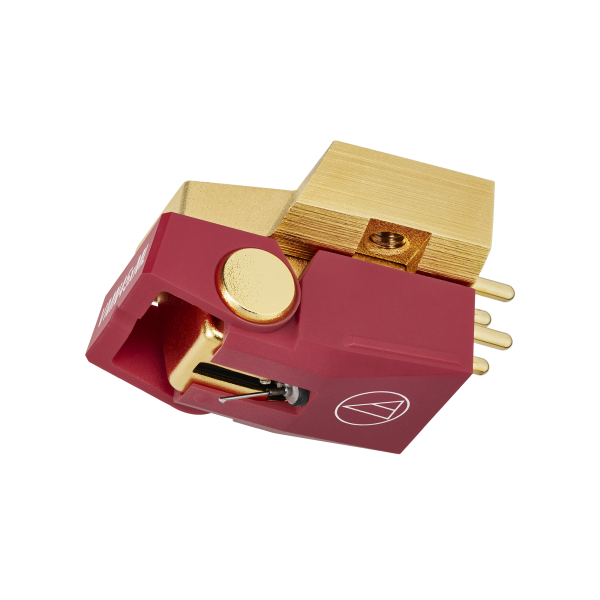

These new audio technica look very interesting.
I’ve been using Nagaoka but I’m tempted just to use it for 78s and go back to Audio Technica for stereo
