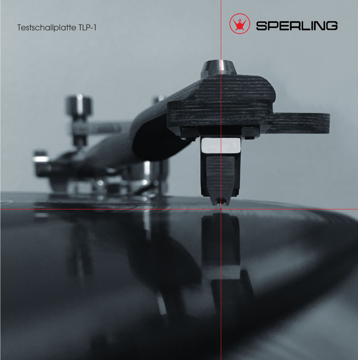

Korf is back to blogging - interesting article about cartridge alignment - might have to buy that test record, too - 1kHz on both sides, throughout, 33 on one side and 45 on the other side.
Edit: Example measurement
Real world and theoretical don't always intersect in the predicted manner. Interesting read that needs some independent verification.
I agree - I thought it is interesting enough to post it here, the record is certainly something I will order. It gives one time, vs the short tracks on other test records...
Haven't seen someone do the tests like this before.
Distortion is calculated at 10 cm/s. Test record is -10 dBu. Whatever that means.
I think, correct me if I am wrong - Mr. Korf took the test and data from the VLADAN M. JOVANOVIC article he quotes, and replicated it with the Sperling disk's 1kHz across the whole record surface - to see what figures he gets, compared to what the Loefgren A and C would state in THD to be expected. The man makes a good Tonearm, and I follow his blog, always an interesting view from Korf Audio.
What is needed is 5 or 10 cm/s velocities. But other distortions swamp the LTA error anyway
I did the same experiment using another record with varying results... Tried to buy the record Korf used, but I could nor purchase outside Germany

I could not choose my country for shipping, only Germany as option it seems, please me know if you find out how yo get shipment outside Germany
I had the same problem with UNITRA, I eventually got one - haven't had time to use it, Life... @ThomasA is waiting for me on that one... I'll find out and post it, if there's a way.
