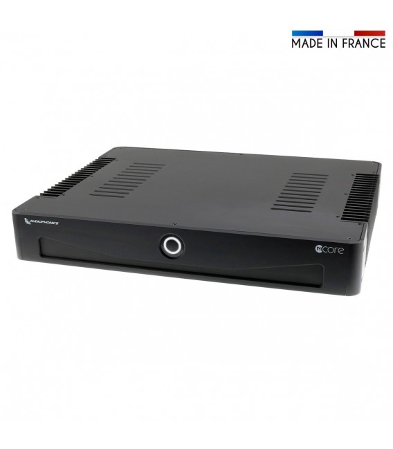

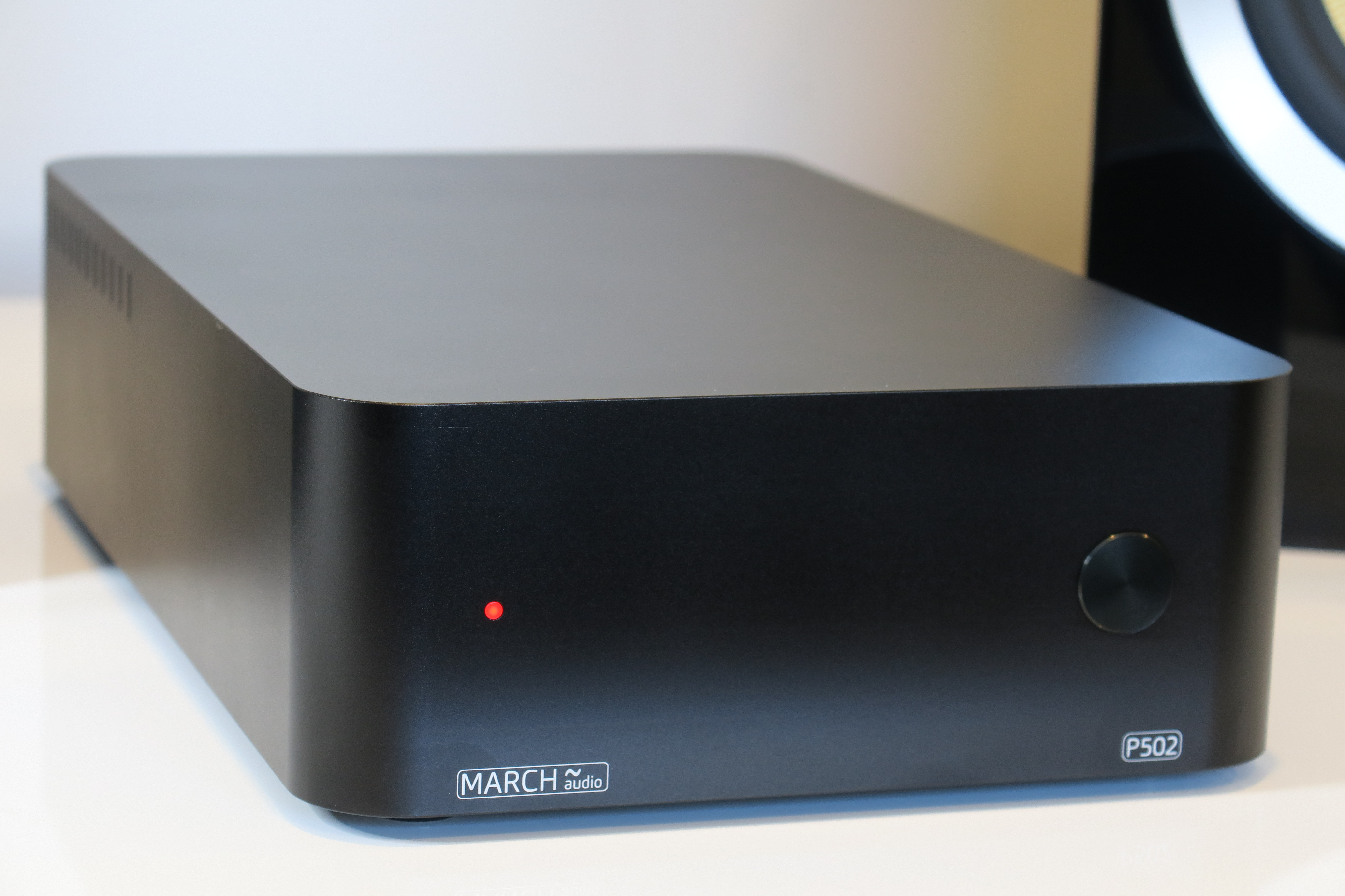

Since you're in Aus, you may want to take a look at the March Audio Hypex NCore class D offerings;
... or if you don't mind importing;
Or you could get a smaller Topping PA5, but that will only give you 60W per channel, which may go into clipping territory when you turn it up to "pump the bass";
