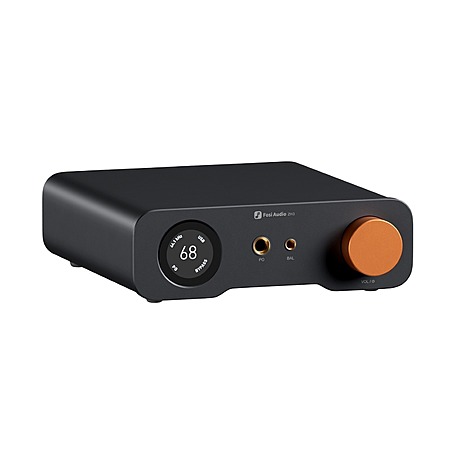

Its quite a sweet sounding unit. i'm using it just for pre-amp duty right now.
Running balanced XLR to one PA5 II+ for the main speakers and the RCA to another PA5 II+ running the subs. Both outputs are active

Yes AUX is one of the output options in the menu. it activates the rca and xlr
I also tried all the filter settings and couldn't tell the difference between them

Not in any measure of sound quality. If the Fosi has features that you wish the Topping had, then perhaps.

The RCA inputs are not for a turntable
I have asked the manufacturer about the RCA input sensitivity.
It is claimed to have 0.775 Vrms.

This from Audio-Technica, in response to my question about connecting my turntable:
"Your A/D converter will be expecting a line level signal (unless the converter has a phono preamplifier built into it) so the phono preamplifier inside the turntable will have to be used (set the preamp selector switch on the back of the turntable to the line position). When the turntables internal phono preamplifier is used, connection of the ground wire is not required."
They went on to say that I could just connect my turntable to the ZH3 with two RCA cables and flip the switch on the turntable to use the built-in phono stage.

Sure. That switch makes it normal line-level and corrects the bass (RIAA) - the bass is recorded lower so that needle stays better (consistent) in a groove. Many turntables don’t have it (inbuilt correction) and require some external device to do RIAA and amplification. Some turntables offer even digital output built in. It can happen on analog signal or in digital domain. The ZH3 doesn’t do turntable preamplification.

Do you know exactly which output under what impedance load is the 0.775 Vrms input sensitivity referenced to? It could be referenced to the headphone out in high gain. I would not worry too much about it, since you attenuate the output with the volume control in any case.
Yes, thank you very much for your feedback. We would like to address some of the points you raised:
1/2. The ZH3's headphone amplifier circuit is a Class A/B dual-power fully discrete push-pull differential complementary balanced circuit. Therefore, it may generate slight heat even when no music is playing. Please rest assured that we have conducted rigorous testing, and this will not affect the normal operation or lifespan of the device.
3. Yes, considering that some customers may prefer linear power supplies, we have used a DC 12V power interface to allow users the flexibility to switch to different power supply methods if desired.
4. We sincerely apologize for any inconvenience caused. However, we are not entirely clear about the issue you mentioned. Could you please provide more detailed information about the specific problem?
5/6. The device features five levels of screen mode adjustment. The "2min" setting refers to the auto screen-off mode. The other four levels allow you to freely adjust the screen brightness.
7. When operating in a non-BYPASS mode, the signal is affected by EQ adjustments, so a change in SNR is normal as the music signal is altered. However, dynamic range should not be significantly affected. Our analog input-to-output path is fully analog, with no ADC conversion involved.
