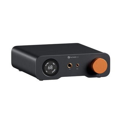

Hello all,
I've bought a fosi ZH3 and I have a little noise problem in my headphones (akg K371) when the screen is not at 100% brightness.
My configuration is: ZH3 connected to headphones, USB to the computer and XLR cable to active speaker (active speaker are always OFF (no power but AC cable connected) when testing).
I heard the noise (very quiet but audible) when there is no sound and the screen is NOT at 100% brightness. If I set the gain from L to H the noise is louder. If the screen is at 100% brightness --> no audible noise in headphones.
I do some tests and the noise change when setting different % of brightness (25-50-75). If I remove the XLR cables --> no audible noise... If I use just one XLR noise is audible but not so loud. I think the brightness is controlled by setting a different duty cycle in the LED (like in LED flashlights) and it's the cause of the noise. May be something linked to a loop (XLR - AC ground - DC supply) ?
If someone has idea ? (don't know how to tag Fosi here ;-) )

Hello all,
Update:
If I use another headphones, DT990 pro 250ohm, I heard nothing...I think it's also linked to the high sensitivity headphone I use (akg K371)
@amirm (yeah I found how to tag someone ;-) )
