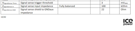

It's not the PS,it's the child diseases first Signal sense circuits had if not lowpassed and a sensible threshold is put.
That's is how is properly done,4-5 years not a single event:

Would noise picked up by single ended cables be an easier explanation
Almost certainly - and most likely ground noise. This is almost certainly a system issue - not a FOSI issue. (As are all ground noise issues). Although as @Sokel points out, FOSI could improve immunity to such events (at the expense of the amp not turning on as quickly when music starts)

Try disconnecting the input. If it still powers up from standby when you switch the LED it is definitely mains borne (or possibly - though unlikely) radiated)
If not then it is noise on the input. Which could be a grounding issue, or it could be disturbance caused inside your source.
