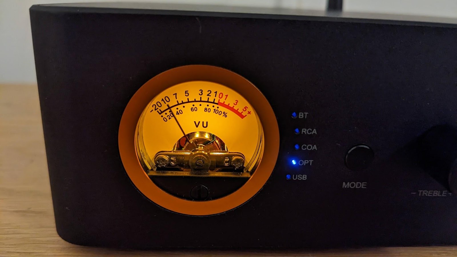

Another thing I liked is the automatic standby feature. It automatically goes into standby mode after 2 minutes of no audio signal - it will help my power bill as I often forget to turn off the amp.
The "Mode" button was a little difficult to play with in a dark room. Input labels are not illuminated, and the little dot LED next to the label was not bright enough to help me read the label.
The VU metre is a nice touch. It is mesmerising to watch the movement of the needle. However, the volume has to be reasonably high to see most of it. Imagine yourself sitting alone at night, a glass of whiskey in hand, and your favourite jazz track playing. But you don’t want to wake up the family, so you set the volume low. Sadly, the VU metre is not working as hard when you kinda want it the most.

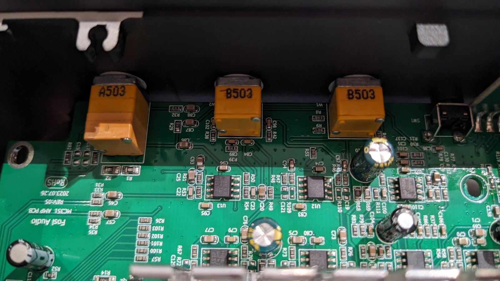

I opened up the case to examine the quality of components and upgradability. Most components are surface mount, except for the electrolytic capacitors. One thing I instantly noticed was the beefy 4700uF reservoir capacitors. The inductors appear to be from Sumida. Unlike Fosi’s other recent products (e.g., V3, ZA3), I couldn’t see premium brand components like Nichicon and WIMA capacitors.

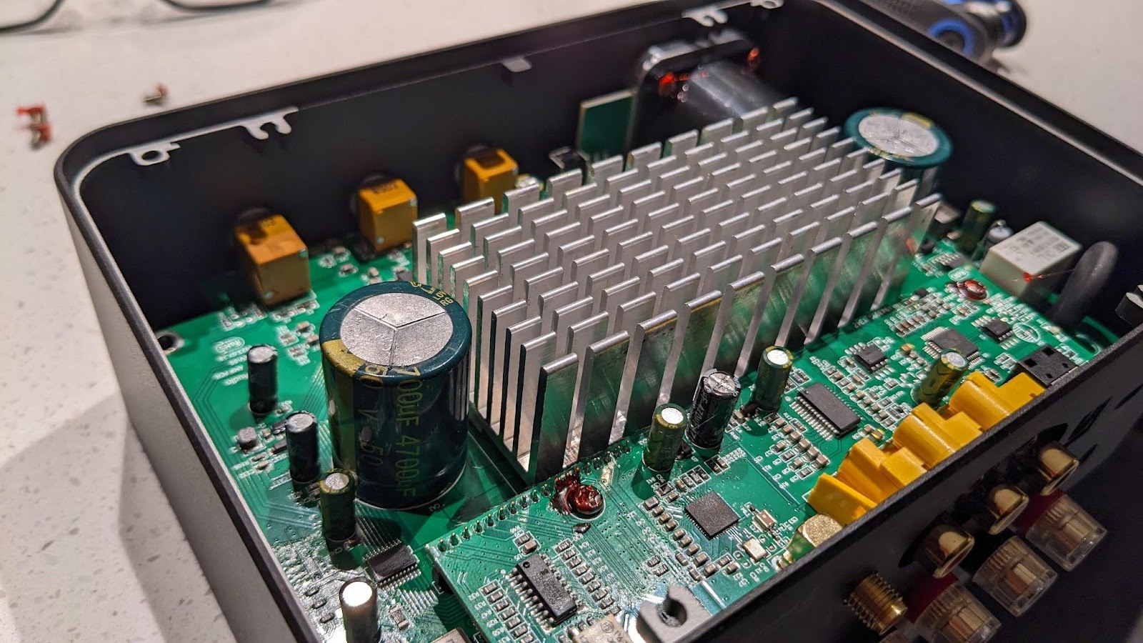

I wanted to see if it allowed opamp upgrades, but it didn’t look promising. I spotted 8 NE5532 op amps, directly soldered onto the surface of the board.

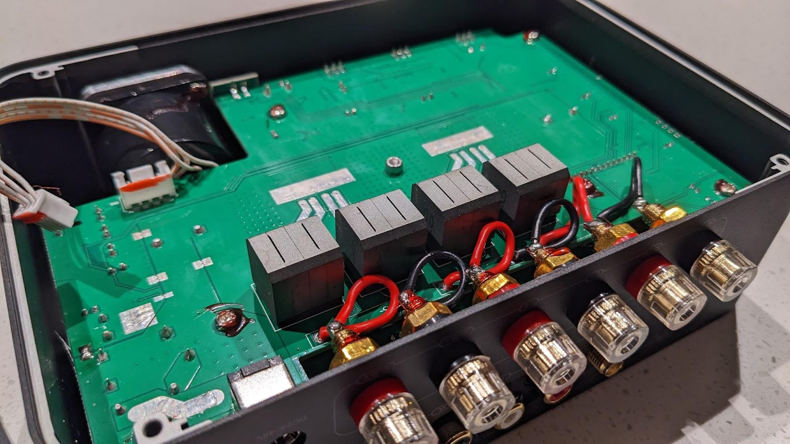

A separate board is the DAC and Bluetooth. I was unable to see what lies under this board as I failed to undo the screw.

The heatsink is large. The chassis is a lot bigger than typical Fosi little amps, and plenty of space inside should help cooling. The caps are rated at 50V. If you use 48V power supply to squeeze more oomph, these caps will be driven a little hard. I am happy with the standard 32V power though.
