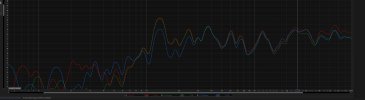

I did some REW sweeps and the results are interesting. The 125H HPF definitely is cutting off the requency in bypss mode but it seems to be cutting off at 300hz instead of 125.
