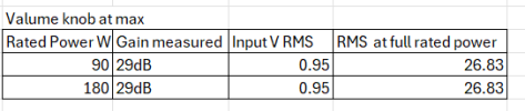

While I haven't tested 2V input I can confirm that 1V will achieve max power as the measured gain from RCA input is 29dB or 28.183X . I haven't measured gain from XLR at this time. Will this matter for music - probably not as music is not the same as test tones and music level vary even from album to album unless normalized. And who listens to the music turned all the way up? Either way if your DAC has no volume adjust you will have the ZA3 turned down a lot . If you do have Volume adjust on a DAC that will be turned down to normal levels so either way no problem. In case you need every dB of dynamic range you will not be using these toy amps.
Power at different input levels RCA

Gain measured from XLR inputs in my unit is 37dB . That is very high . Turning the volume knob from max to the 3 O'clock position reduced the gain to 27dB. Channel mismatch at this setting is good (0.2dB )
