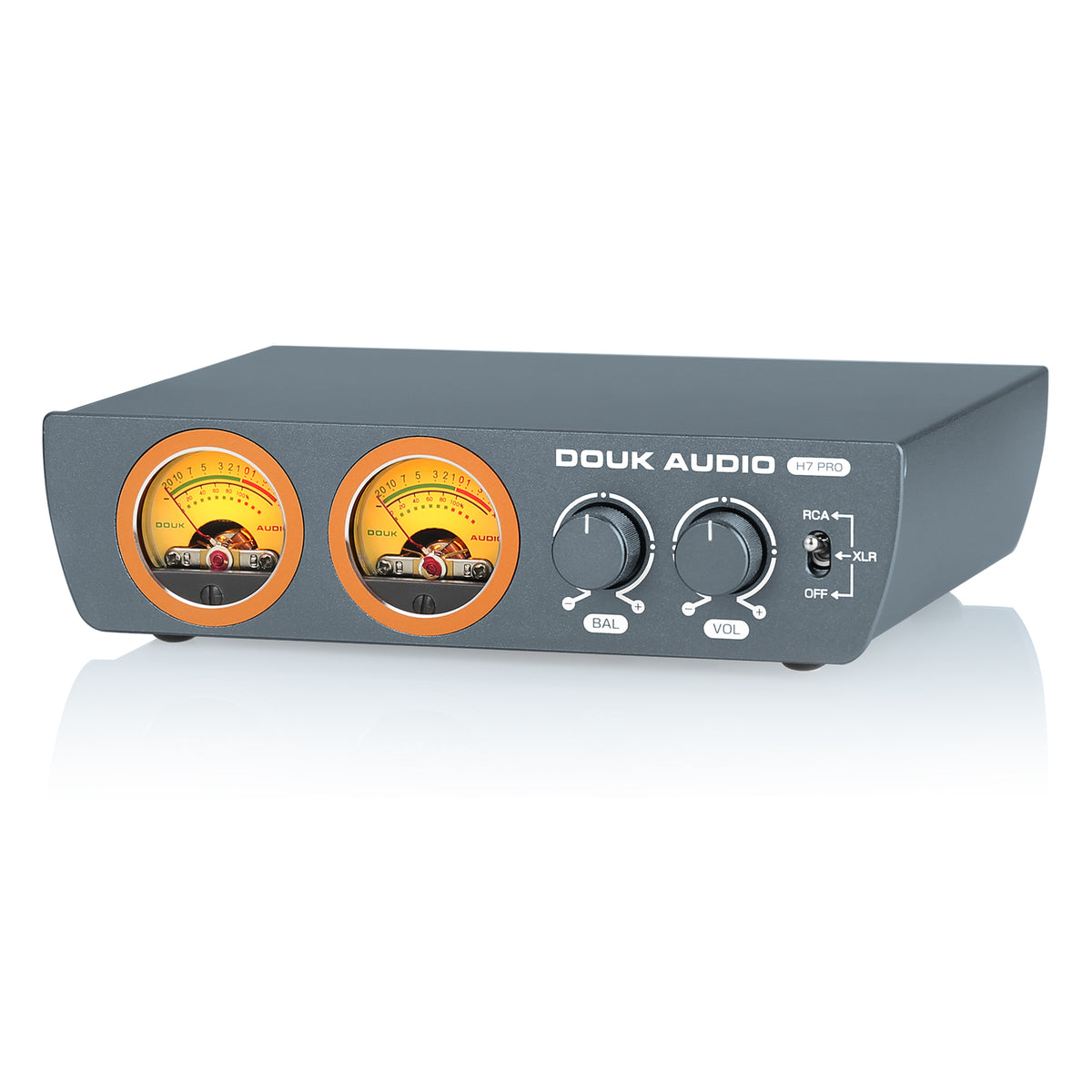

Douk H7 is probably the closest thing to what you want since it has separate volumes for left and right channels. They are releasing a Douk H7 Pro model that is an improvement on the original H7, also.
