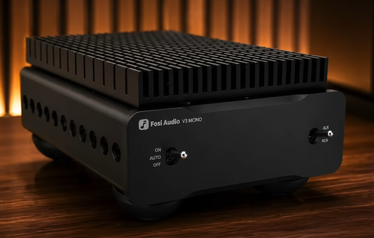

I am quite interested in a pair of Fosi V3 Mono but I am hesitated to buy them mainly because of its tendency to overheat.
Excessive heat could drastically reduce the life span of an amp. I understand that it is designed to use its metal shell as heatsink, hence the high heat.
But I don't like that approach at all, apparently, I am not the only one. Some guy on YouTube added a heatsink on top to help cool down the amp.
Has anyone here done anything similar? If so, what did you do? Did your Fosi V3 Mono die of overheating? I want to find out how this amp performs in the real world.
I have them! Just two 5 volt fans- usb- is enough, yes they run very hot, but they sound very very good. Fans are needed.
Has anyone here done anything similar? If so, what did you do? Did you Fosi V3 Mono die of overheating? I want to find out more how this amp perform in the real world.
You know, I'm a big Fosi booster in general, but I would not buy a set of V3 Mono amps at this point. Enough people reporting problems with them, and over a fairly long span of time. Given the way Fosi works, I would not be surprised to see them develop a new version of this pretty soon on the budget side to mirror what they are doing with those higher end mono amps they have teased. Or, in you need monos right now, Aiyima just came out with a new attractive product, the A20. Their site says sold out for now, but I imagine they will ramp up production on this quickly if it is selling well.
Yes l had to send 3 of Them back, non working, (!)
I am quite impressed by Aiyima A20 Mono amps. I was wondering which one would be a better choice. I suppose I will go with Aiyima A20 Mono amps now.
It has slightly lower power output than I would like compared to Fosi V3 Mono, but at least it won't be having any issues with excessive heat.
