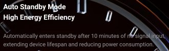

I'm a bit confused: is auto on/off 12v trigger or signal sensing? I can't tell from the picture if there's a 3.5mm input on the back. Screenshot from Fosi web site below looks like it's signal sensing. They only mention auto off, not auto on. They should clarify that.
