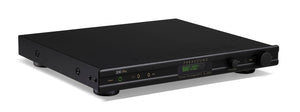

…I've never heard of a x/over, active or passive ever built into a pre-amp…
Never seen this:
Or this:
