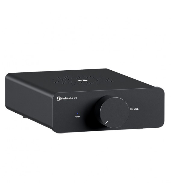

Denon is ok the same with yamaha, yamaha just can't play bass very good
Nad is good but dson't have anything cheap that comes closae in price relative to other amps like the original nad 3020 amps
Cam,bridge audio cxa25 is to expensive for what you get and don't have enough power AND it to also isn't great at playing bass.
Even when i don't use my ifi signature v1 dac with the good psu, my fosi audio tb10d + 32v 10a + good isotek power cable, sounds above avarage, i don't want to pay the price for a yamah,denon,nad,cambridge audio entry level amp
and the v3 or the tb10d

Fosi audio is a much better deal even if you buy the tb10d + better power supply and power mains or the v3 + 48v psu for under 150 euros for thoose on alow budget, a much better deal for those who like good sound in a compact size
I would get the 48v power supply regardless, as you might change the speakers or room in the years ahead.
Use this to calculate how much watts you need. Try to get to 96dB to be able to listen a bit louder. Consider that this calculates one speaker, you need to add +3dB if you use two, like most of us, so you aim for at 93dB, more is better:
It also depends on how much you put into the RCA connectors, but let's just assume it's a perfectly implemented streamer that outputs clean 2V max.
Yamaha states 87dB sensitivity for the NS-333. In my room i would sit 3m from the speakers and they would be 80cm from the wall. To get to 93dB (plus 3dB for the second speaker to reach 96dB), i would need 18W.
This of course is just estimated, as it depends on the source output, the music itself and so many other factors. My guess: It's enough for loud music, but you won't bring the house down with this speaker/amp combination. It would be more than enough for my taste.
it's 6db increase buy adding a second speaker that plays 93db = 99 db

That would be the case for coherent sources where amplitudes add up (+6dB). But i think we can consider two speakers in a room to be not coherent, so only power adds up (+3dB).

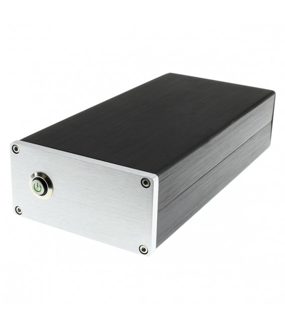

With the 32V PSU the measurements gave 32W into 8ohm and 62 into 4 ohm. With 6ohm speakers you'll be roughly half way between the two so around 47W. These are figures for clean power. For the more common 1%THD rating (to compare with published specs of other amps) you can probably add 20% or so. So maybe about 60W.
Your speakers are reasonably sensitive at 87dB - The 32W will be fine for close listening (eg a desktop situation). If your listening space is more "living room" then you might want the 48W. It does give loads more power.
I got the 32W because with the discount that was available on that, I can buy the bigger PSU later and still pay the same as buying the amp with the big PSU from the start.
I have a quality 32v 10a psu and im not shure i want to have a 48v 5a power supply for the same price (euros,from a european store) of avarage quality,then a high quality psu, mabye i could for 100 euros get the higher end psu https://fosiaudioshop.com/collections/power-adapter/products/fosi-audio-48v-gan-power-supply .
I just think since it's a laptop shaped psu it can get much hotter then the bigger one (size) i have, also think the 48v psu makes any tpa3255 based amp much hotter then a 32v psu, even when you play the same level,power, as i know the amp uses 32 or 48volt with the bigger psu all the time, therefor a difference in heat
How ever i wouldn't mind trying a 48 volt psu to hear the difference in power and if there is like some say, a difference in sound quality

Has anyone actually measured the output of those PS? I wonder what it would be in both dc and ac. I am using it at the moment but will do it with my cheap multimeter later.

Beginner question. For the best amplifier performance from the Fosi V3 (least noise and distortion) and I plan on controlling volume with another device, should I leave the Fosi V3 gain at max? Or a little lower than max? Or whatever my prefered max listening level is when source is at max?
If it makes a difference I'm using the Fosi 48V 5A power supply, 8 Ohm tower speakers, and two audio sources. One source can produce 2V RMS max and the other can produce something lower like 1-1.5V RMS max.
I'm also getting a trigger controller power strip so I can leave the Fosi V3 always on at a set gain level and switch it on/off with a trigger output of a source.
Thank you! My first post. Thank you Amir for all the reviews!
If you have a voltmeter, you should just measure the highest setting that has the least channel imbalance, which very likely is full volume.
Most would just put it in full volume and call it a day, i did.
