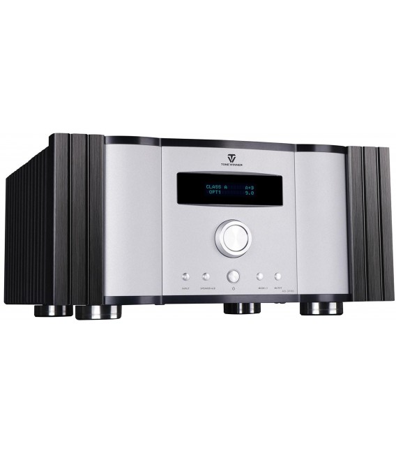

But what intrigues me is the volume control solution ... i would like that Fosi Audio would adopt one ... pga or NJR units i mean
like the NJW 1195A
just look where it is used ... a 2400 euro unit
it must be very very good indeed I have another preamp the old Hegel P2A ... it uses a PGA something ... cristal clear
i tend to think that the days of very expensive stepped attenuators are close to the end
People who do not like chips is because they have not tried the best ones ... as usual prejudice is a bad beast
