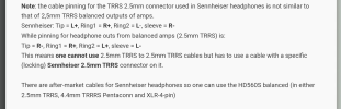

The balanced cable below works perfectly for me. There were no issues with the 4.4mm socket, the plug just clicks in / seats really nicely, both channels are fine:
[Edit: tired eyes saw the wrong thing...see my post 398]
That isn't a balanced cable at all. If it works then the minus rings of the Pentaconn are not connected at all. It is unbalanced from the Pentaconn to the TRS.
@AndiGee That said I tried several Pentaconn cables (all balanced) and none showed the issue that you describe.
Looks like the genuine balanced cable from Sennheiser??:
Looks to be a genuine Pentaconn to TRRS cable.
Headphones like the HD560S support this:
Source
Thank you all very much for your feedback, I can relieve fosi as well as the manufacturer of the XLR adapter 'ddaudio' - the problem with the non-functioning connection was ... me. I just didn't had the courage to push the plug into the socket until the final 'click'. It takes some kind of force, and I was a bit afraid of damaging the little device.
