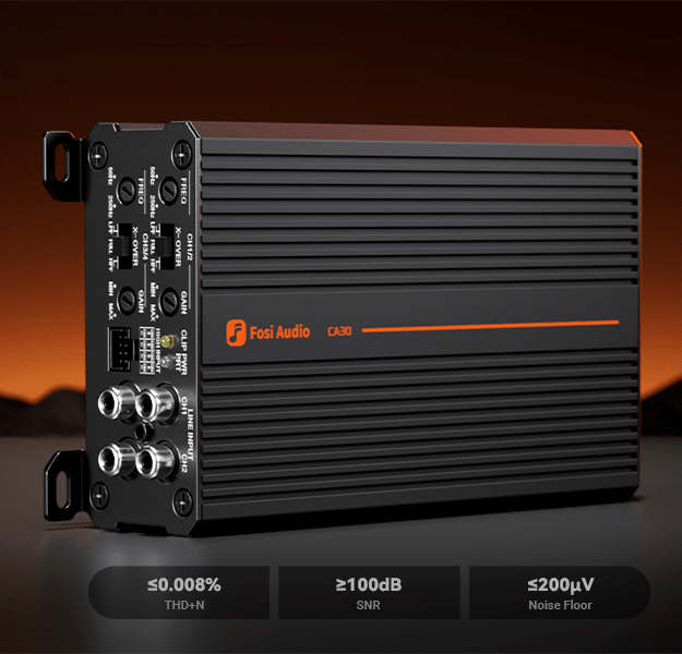

Stumbled on this, been out a while, IMO deserves more investigation, I may sponsor having one sent to @amirm to verify their specs.
Infineon IR4322 Class-D chip - why not TPA3255 ?
Yes designed as a car amp, runs off 12V my primary use case is off-grid partly "nomadic" so would set up power conversion to use in normal S&B homes as well
4 channels per small unit, roughly 100W per channel into 4Ω at 1% THD, 140+W into 2Ω
"up to" 320W x2 bridged into 4Ω
so lots of value and flexibility for subs, multi-channel, 2–8Ω speakers and 4Ω subwoofers bridged
crossover control on all channels, 50 – 250 Hz either LPF or HPF or FR bypass
high-level (speaker) and low-level RCA inputs
claimed noise level of ≤200 μV, THD "as low as" 0.008% @5W, SNR > 100 dB SINAD ≥80 dB
input sensitivity 0.75 – 8 V !
damping ≥140 (100 Hz @ 10 W)
I saw "4-channel, 3-channel, or 2-channel bridged modes" !! but the manual only shows 2- channel, if anyone can explain how to do 3/4-channel please do!

Well usually channels 1&2 bridge, which would then make a 3-channel amp. Further bridging channels 3&4 would then make a 2-channel amp.

I bought one for a 12 volt portable stereo rig in a Harbor Freight Apache 3800 case. I wanted something better than the many builds out there using Wuhzi Audio amps based on TPA3116 and TPA7498 chips. The Infineon chip used in the CA30 is at least as good as the TPA3255. Infineon is a European company and they purchased International Rectifier and all of their intellectual property regarding mosfet Class D amp designs. IR was the company that originally solved the big problems with Class D amplifier output stages and the high distortion they were originally known for a decade ago. Nothing wrong with choosing an Infineon chip here. Helix also has an amp based on this chip.
So for the portable build, I used Morel MW144 drivers for the low end and am trying different drivers for the range 500 Hz and up. The Morels are very good midbass drivers and a distinct step up from most of the builds out there. I started with CDT Audio wideband drivers in small metal pods mounted to the sides of the case. I am also going to try One Audio 3" wideband drivers and expect I will like them more. Initially, I am using the Fosi built in filters which only go up to 250 Hz. I am also programming a TinySine DSP board for active crossover and PEQ for the final solution.
Initial impressions. The Fosi delivers. The sound quality is very good and the amp drives the inefficient Morel drivers very well. The CDT Audio widebands are a bit bright on the top end and need EQ but that is not the fault of the Fosi amp. I should add that I have a collection of high performance SQ 12 volt amplifiers dating back to the original Nelson Pass designed Soundstream D200 and including good amps from Alpine and ARC Audio. The Fosi holds its own against those far more expensive amps and works well in my battery powered application. I use 2 12 volt 16 amp hour LiFePO4 batteries in parallel and they run this rig for about 8 hours. I am using a Teyes CC3 android head unit with optical SPDIF output going to an SMSL DAC.
i should add that with this application, most of my listening has been nearfield without all the background noise present in an automobile application. Problems with noise and/or distortion will be far more apparent in this use case and the amp is clean.
