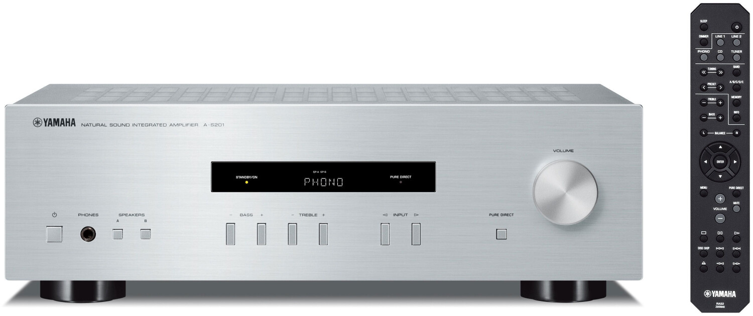

I don't know of any Japanese ABs that cost 100 euros, and certainly none under 400 that deliver real 100watts into 8 ohms
Neither do i, but this Fosi doesn't deliver 100W into 8ohms unless you buy the bigger power supply, which costs something as well, say 40€. So you are at 140€, not sure if sales tax is included, but let's assume it is.
This can be bought for 190€, so 50€ more.
I am not familiar with other brands offerings, but i guess if we looked, we would find similar things from Onkyo, Sony and so on, maybe an with even smoother frequency response and more power.
Don't get me wrong, i voted fine for this Fosi one, but it's only a good deal if you ignore the competition.
The as 201 Gives 100+100 into 8 ohms at 10%thd..... we are comparing apples and oranges.
Screenshot_20230428_114130_com.amazon.mShop.android.shopping_edit_1889812525298611.jpg
In addition, I paid about 100 euros with a 48V power supply
