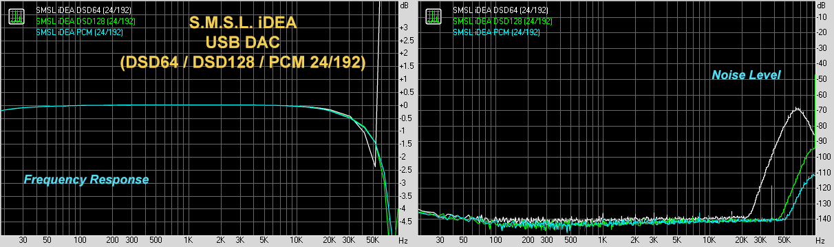

Noise level sharply rises above 28 kHz. This is a feature of many DACs where noise in audible band is pushed into ultrasonics. The levels though seem low rising to "only" -85 dB. But that is misleading because FFT analysis artificially lowers the noise output of the device under test.
it's typical spectre of noise from dsd64 (converted to dsd64) sound, without digital or analog filters at 30-50 khz.
