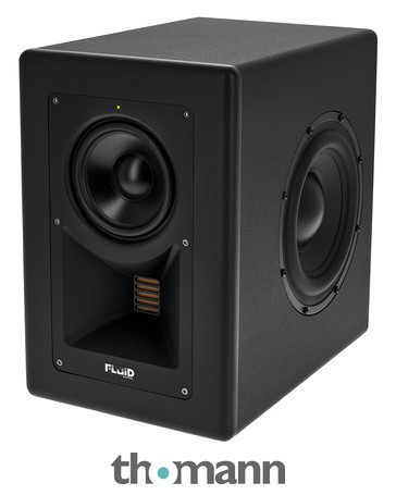

I see these are now on "super" sale at Thomann, probably a promo they did.
And shipping world wide as I can see is pretty good. 2 units to California as an example is $157 with UPS so total $2795 for a pair.
