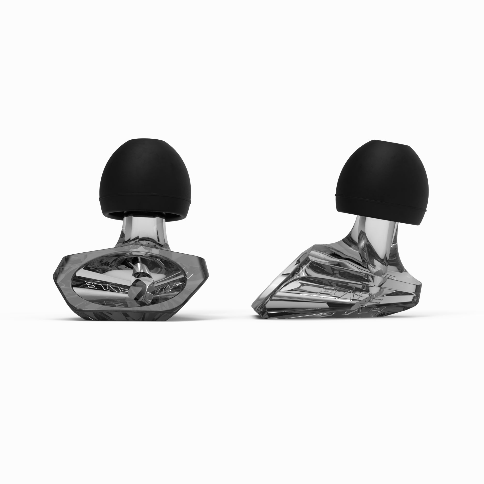

Flare Audio Immerse ear inserts??
Thanks for all your input. Both educational and ultimately, money saving!
I was just about to open a thread on this too. Yeah, it also came up on my FB feed as an ad. It's an interesting concept for sure. Price is not insane if they actually DO something. Is anyone here using these yet?

It is said to eliminate resonance by up to 21 dB.
On YouTube, I also saw mentions of "removing HRTF."
What could that possibly mean? - or Why would they want to remove it? I don’t quite understand.
googling it, the HRTF is the "head related transfer function", which is apparently the sum of the ways our head and ears modify sound between a source and when we "hear" it:
So basic premise is that the ear's frequency response isn't flat because of its physical shape and they compensate for this. Yet they also say themselves the brain already compensates for this. So using their product will, erm, do what exactly? Don't get me wrong, the basic idea and physics of it might make sense, but it would be interesting to first figure out if this is needed/wanted in the first place, let alone a single device would have the same effect in all persons. Apart from that, it's hard to take this serious because of the sheer amount of buzzwords.
I don't think the main feature is flattening the response curve, in fact, that could be a disadvantage. I think they think the main advantage is removing the ~21% distortion that reflections caused by the outer ear add to the incoming sound.

Difficult to see how they are going to do that. Certainly their animations have totally failed to show refraction of the sound waves as they go through apertures at dimensions much smaller than the wavelength.
Meaning there will be reflections along the length of the device itself, as well as in the ear canal once the waves have left the device.

You're right, should have worded that differently I didn't really mean 'flatten', more 'make ideal'.. Or shall we say 'immersive', lol. However it doesn't change the vague explanation and what seems like contradictions ('distortions occur naturally' and 'brain tries to filter this distortion which results in a loss of detail').
the distortion created by our outer ear
…is called pinna cues of the human auditory system and is considered of vital importance to discriminate between front and back as well as up and down.
If what this company is claiming is true this should be an area of very interesting research
Agree, its either this or marketing BS. My money is on the latter.
On their webpage they show how sound waves travel through the ear canal being reflected inside the canal. Given the wavelengths of sound waves in the frequency range of interest (many centimeters to meters) in combination with the typical diameter of human ear canals (approx. 0.7 cm) laws of physics don’t allow this kind of wave propagation inside the canal. It reminds me of showing staircases to prove that digital signals lack resolution…

No, I don't think that's what it does. What they are saying is that the distortion produced by the outer ear is worse at 2-8 kHz and their device reduces the distortion.
Ahhh, ok. Do they say what kind of distortion?
idk, they are rather thin on the details, hence many of the comments above and a general disappointment on my part that they can't seem to point to any scientific data for their claims.
you would only be using them while involved in stationary activities like 2 ch audio listening.
For a proper soundstage in front of you from a stereo sound reproduction system those pinna cues are required, too. Otherwise you will have the same experience as with binaural recordings or dummy head recordings listened to via headphones: the soundstage is far too near and above or behind the listener (typically).
That makes sense since the „problem“ they want to „solve“ (reflections from ear canal boundaries) doesn’t even exist in the first place. This is a solution asking for a problem…
