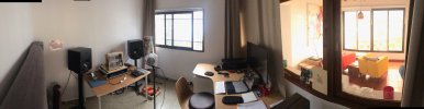

I am attaching a photo of what my room currently looks like.
All the best and a nice Saturday,
Waldemar

Your room size, layout and construction is truly suboptimal, to say the least.
You've been shuffling your room setup around a bit, recently.
Did you experience any notable improvements at all?
Judging by the measurements I'd guess no!
First, try that mattress behind the desk/speakers horizontally vs. vertically in the current setup.
Then, try that mattress vertically behind the desk/speakers, set up at 45°, facing the corner between the walls without windows.
I'd guess this helps a bit to tame lower mids on down.
It's probably always a good idea to pull the curtains over the glass surfaces to help tame reflections a bit from the midrange on upwards.
Ideally put something on the ceiling to help diffuse reflections a bit from the upper mids on upwards.
Filled but not necessarily tightly packed bookcases, covering most of the walls' surfaces, always help a lot from between the lower mids to mids on up.
Due to the wavelengths involved, remaining problems from the lower mids on down must be tackled with DSP, but by cutting peaks only.
Nothing you can do for the throughs, other than changing placement of speakers and listener - not too practical in that size room.
Once gone through optimizing all the former, consider adding your sub to the picture.
You'll then soon enough recognize that this opens yet another can of worms ...

If I understand you correctly, the subwoofer will create more problems than it solves?
If that's the case, no problem, that's how it is.
Then the last option would be DSP, but it's not certain that this is the right way to go?

Since you already own subwoofers, you may as well use them.
But to be honest, with a setup like yours, I wouldn't really bother. Your speakers are behind you when you are using your PC, the room is too small, speakers are too close together. Up to now we still have measurements which are uninterpretable because of very poor signal to noise ratio. Just looking at the measurements of your noise floor, I would think there is a TONNE of noise where you are, but when I asked you about this previously you said there isn't much noise.

What I actually meant was, that it'll be best to go one step at a time in a logical sequence to wring the optimum from what you have.
So first of all, fix room acoustics problems physically as best as possible to optimize measured results, and then,
secondly, use DSP to tame room mode peaks and tweak overall balance, and once that's done,
thirdly, add subwoofer(s) and physically best integrate to optimize measured results, to then,
lastly, use DSP once more to tame newly generated room mode peaks.
Trying to do all at the same time will just introduce more confusion and frustration than it'll help fix your issues.

Now I read Keith's response ... okay ...
... you are trying to optimize the sound at your PC desk, and not in the speakers' near field, facing the speakers!?
No,
this is my workplace.
To make music, I turn around. For me, music is the hardware.
I have to improvise and make the best of the current situation.
I can place the speakers even further apart, where should I then sit in order to keep the length of the triangle to some extent?
