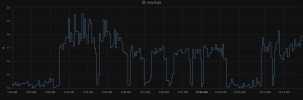

Power usage graph (10s update frequency) at high output.
So a 5W delta between low, where it is probably idle, and the peaks of "high output" listening. Goes to show how the 5W power level Amir chose for SINAD is relevant. :)

I use the 18 port version of this: WattBox WB-800VPS-IPVM-18
It provides power values as well as power control of each outlet. This is in a rack where I keep all my gear.
That device has an API you can connect to and control all of it, as well as pull all the power status. It does NOT record data usage internally, I wrote a custom piece of software to do that (software engineer by day). So out of the box you just get a web UI with current values, no graphs/history. Let me know if you want any more details.
