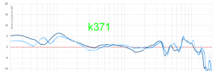

There is something I still don't get : why your measurements of the AKG K371 show as much bass as the Fiio FT1 when with a direct comparison of the two, the Fiio is obviously bassier (and too much) than the akg ?
When you say "a direct comparison", do you mean your own personal experience listening to them ? If so as we've discussed a bit before in this thread, know that for some headphones, and these two are such headphones, bass response can vary rather dramatically between listeners, in situ, on your own head, depending on your anatomy / hairstyle / glasses, etc. It could simply be that the FT1 seals better on your own head than the K371 for example, and as a result produces more bass (and it could be the opposite for someone else among other possibilities :D).
It could also be that the treble response is quite different between them, in situ, on your own head, vs your anatomically-derived individual "target", and as a result makes you perceive the rest of the spectrum differently.
Same will apply when measuring on different test fixtures with varying geometry / pinna / etc.
Rtings is one of the very few publication measuring bass output on a cohort of real humans to assess consistency, it's one of the things I appreciate the most about their tests and a great service to the community : https://www.rtings.com/headphones/graph/30572/consistency-l/fiio-ft1-vs-akg-k371/71934/1671
Thanks for your answer.
Yes by direct comparison I mean my own personal experience.
I know this is not scientific but it seems I am not the only one feeling this bass difference between these two headphones. As far as I remember Solderdude on his blog felt the same and the difference is visible in Oratory measurements).
One thing I like in Rtings measurements is in fact the FR consistency graph but here again the K371 performs better according to them.
Trying to find why this diff. Yes the K371 have more treble peaking in their test, maybe this!
