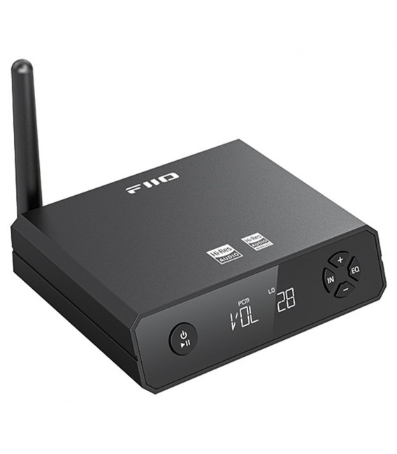

Can anyone tell me if the Fiio BR13's PEQ equalizer can be used with Spinorama EQ values? I mainly stream via BT Ldac.
Hola,
I have the BR13 and you can only manually set EQ. There is no function in the FiiO Control app to import files.

Nice thx for the answer
Can I set manually the spinorama EQ via Fiio control app ?
I mean these kind of values :
Sure. It has 10 bands of PEQ so no issues loading your values.
Can you help me to enable PEQ equalizer, I don't find any option ? (need to setup the EQ type PK/FS)
Sure. I assume you are NOT using the FiiO music app....if you are, that has EQ, like Hiby Music.
For the FiiO Control app, you need to make sure nothing is connected to the BR13 via BT, then connect to it via the Control app.
At the bottom, you can see the button for the EQ. Press that and then you must turn it on to adjust the settings. Top right button turns it on.
Then, press the "current setting", which is Jazz in my screenshot. This allow you to change to a "custom" setting, which is where you can enter your desired values.
Press Advanced button at top to asjust each setting individually.
The PEQ in the FiiO Music app works the same, if you use that to play your source.
EQ is top left in the music app.
HTH....Cheers.
