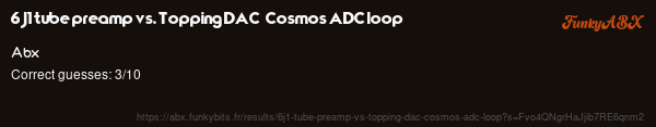

Test - Topping D10s/Cosmos ADC loop vs. Tube preamp (6J1) in the loop
link to the test files:
Please feel free to try the test and tell me if you hear the difference, and do not forget to post foobar abx test report.
I have also included a delta file (Deltawave difference) for you to hear how horrible is the "sound" of tube distortion in isolation. But, can you hear it when playing music?
I have also created an on-line version of the test:
The one time the comparator did not 'crash' (volume clipping and one time playing different tracks together) Linux mint, firefox. I got 5 out of 10.
Thought the high distortion and hum would be easily audible.
There obviously is not a clear 'tubey sound'' sound for me.

Thanks for creating the test, pma. :) So far I don't hear any difference, with speakers I would say. I'll listen more intensively with headphones and see what happens.
However the delta file sounded awful as you mentioned.

Okay, my ears aren't exactly young anymore, 60+, even though my last audiogram suggested they look like a bit younger than that. They’re completely untrained, and I’m using Bluetooth/LDAC (32-bit/96KHz) to feed a DAC and headphones from an Android tablet, perhaps not the best combo.
But to my great surprise, I can't tell the difference between the two recordings
I didn't even try to answer, it would have been a total shot in the dark.
Anyway, thanks for the test and for the musical choice @pma
