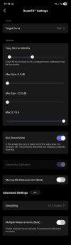

I’ve updated my settings based on your suggestions and tried to interpret the technical steps as best as I could.
Here is what I did:
- Limited the range: I set the equalization to 50Hz - 500Hz
- Smoothing & Mic: I changed smoothing to 1/12 Octave and turned on Moving Mic Measurement (MMM)
- Gain Settings: I lowered Max Gain to 5dB and kept Non-Boost Mode ON
