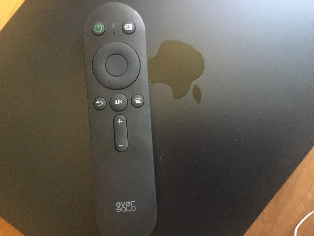

18 pages since I visited this thread, but is it correct that it doesn't come with a remote? :eek: That means you have to have either a preamp or a DAC with a preamp section in addition to this then? :oops:
They now offer a bluetooth remote and I *think* they said an IR remote also works.
Remote on the way, and you can use their ‘app’ on your phone etc to control volume, the app
duplicates every function they call it the ‘cast’ screen.
Yes, I got that the app can be used, but doesn't feel perfectly fail-safe to control the volume via an app when it's connected directly to active speakers. :)
Do you know if the remote can be ordered separately or will be included in units going forward, or both?
Mirror mentioned it as an optional extra, presumably for those that already have a unit, their DAC Z-8 comes with a remote,
I have asked for clarification.
They said it will be an option.
