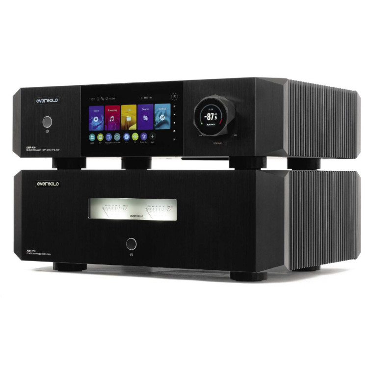

Eversolo AMP F-10 update.
F-10 arrives ( brand new unit) unfortunately one channel down one front LED (VU meters) dead.
U.K. importer collects, two months later unit is returned two channels working unfortunately no front leds!
Not super impressed.
I would hope that if I were a genuine ‘customer’ rather than a retailer ( the importer is both retailer and ‘distributor’ ) they would have exchanged immediately for a another unit.
Waiting for importers to arrange collection again.

Collection scheduled ( again) for tomorrow, it’s probably nothing more than a loose cable but if the design can’t withstand courier handling…
