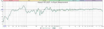

Indeed. When I posted in-room measurements of my Klipsch RP-280Fs, they were criticized for being "very bright", etc. I sometimes wonder if the reaction would have been different if I hadn't mentioned the brand. :)
These would sound bright because there is no roll off in the frequency response at the listening position which normally results from an anechoically flat speaker and room interaction. A flat frequency response at the listening position is not desirable. It is indicative of a speaker thats anechoic measurement will be a broadly rising frequency response up into a peak in the highs, ie. bright.

But that is exactly the point. The "Estimated In-Room Response" of the Sointuva is just as flat from 1K to 10K as the Klipsch (and the anechoic measurements of the Sointuva indeed show a rising frequency response at the high end, yet people are excusing the Sointuva from these criticisms.
I don't agree that the posted EIR for the Sointuva and your posted in-room response are "just as flat".
Am I misunderstanding you? The in-room measurement you posted is at the listening position, correct?
Your measured IR, if averaged, increases about 1-2dB from 200Hz to 10kHz.
The PIR of the Sointuva, on the other hand, drops from 200Hz to 10kHz about 2-3dB.
That might still sound too bright for some, but 1-2dB increase, like your Klipsch, should definitely sound too bright for most people under 50.
As has been pointed out, your In-room response is flat. That is not ideal and would - almost certainly - sound "bright". I know it would based on my experience measuring and listening to various speakers. The speaker measured here is not flat in-room; it has a decreasing SPL over frequency. The intricacies and level of tilt... that could be discussed ... but you have to understand that you are comparing 0dB delta from 300Hz to 10kHz in-seat with the Klipsch vs 3dB* delta in-seat with the March from 300Hz to 10kHz (even with the plateu in the treble (3kHz-10kHz)). Apples/Oranges.
* 300Hz = 81.83dB, 10kHz = 78.5dB
